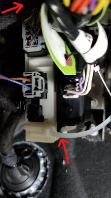

    I used two zip ties, one on the top and one on the bottom to anchor it to the white module. Works great! I get the chirp with a pull of the door handle and full blown alarm with a pound. Thanks Mattio for your posts! They helped me a lot! Alarm_LI.jpg
