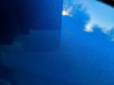

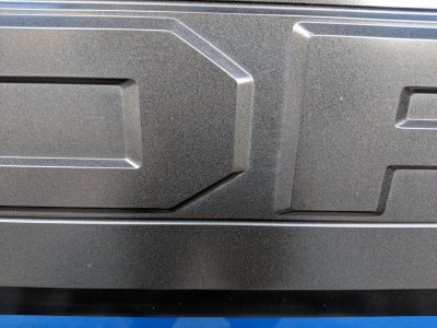

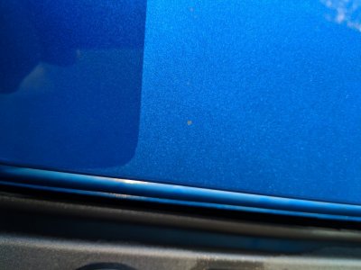

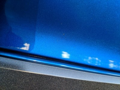

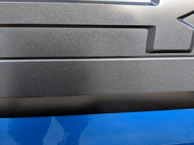

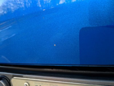

    There's about 20 of these spots on the body in various places
  13. MtopRaptor
    MtopRaptor Full Access Member
    72
    Jun 19, 2017
    Aluminum doesn’t rust, does your neighbor have a B.B. gun?
    This would have to be transfer of carbon steel to that surface of the aluminum.
    Does it appear to be below the clear coat? Or on the surface of the paint? Either way it’s been transferred from CS.

    That is on the paint, not under. On normal steel vehicles rust first presents as a bubble under the paint or in an area where the paint was damaged, thru the clear coat, thru the paint and thru the primer. These are basically oxidized metal deposits on the surface. First thing I'd try is a high quality polish / cleaner. Take your pick there are thousands.. I like the KLASSE products, Chemical Guy products and Adams stuff. This is not a problem - I'm sure of it.. Let us know how you make out..
