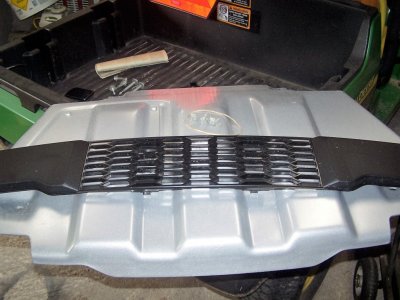

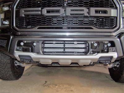

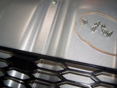

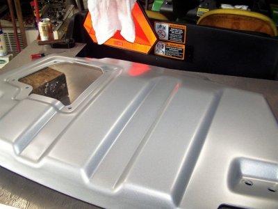

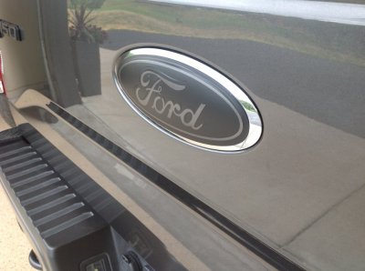

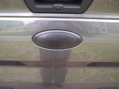

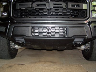

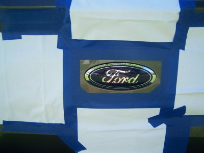

    first mod , paint tailgate emblem and front skid plate . blk plasti-dip, 100_3100.JPG 100_3109.JPG 100_3102.JPG 100_3104.JPG 100_3103.JPG 100_3107.JPG both 5 coats . the bolts for the front skid plate are painted blk not plasti so as no build up in the holes. I removed the lower grill , and carefully removed all clips . taped up all and clean lines around all silver paint

    I need to post some pictures but I just got mine painted "hot rod black" which seems identical to what you have here. I think it looks much nicer.

    If you guys plan on plastidiping the skid plate and bumper, I recommend leaving tow hook grommets in place because getting them back in after the fact is guaranteed to scratch the fresh paint (unless you're completely removing the bumper).
