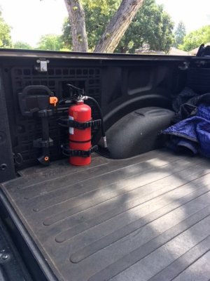

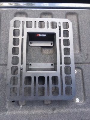

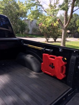

    I had been looking for a bed storage system that would allow storage and maximize bed space. This system seems to accommodate both. My truck has a spray in bedliner. The bedlinen created fitment issues. Originally the manufacture recommended cutting into the bedlinen material to make the panels fit properly. Not happening on this truck. I ended up getting stand off spacers from the manufacture that worked well in getting the panels to fit properly. I have included several pictures of the inside of the truck bed. The gas can isn't perfectly straight in the photo. About 3/16 out. I didn't have the proper bit to modify the holes in order to get it level. I'll be correcting this in the next couple of days once I secure the bit. The only other component not mounted in the truck is the jack. It's on order and will mount over the wheel well by the fire extinguisher. Many of the systems that are out there are complex to install. This system was both simple to install and clean to look at. IMG_1178.JPG IMG_1182.JPG IMG_1182.JPG IMG_1184.JPG IMG_1184.JPG IMG_1180.JPG IMG_1180.JPG

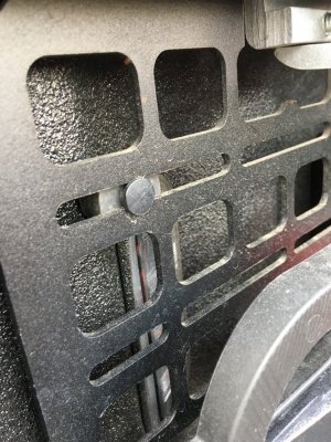

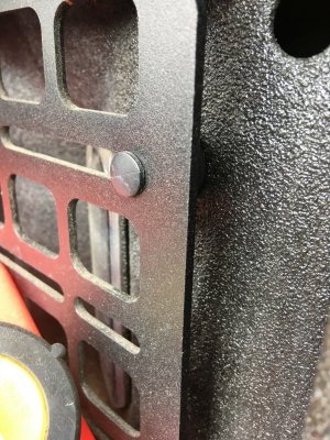

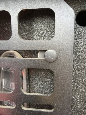

    F5329DDC-B176-4297-9007-7FC99999294F.jpeg D87D0D8C-0173-4966-BBA4-B3BCD9E42CB6.jpeg 973922D7-BD89-4C6E-AC36-4BE3FD88C567.jpeg Brapptor sorry for the delay in responding. I’ve included a couple pictures of the round rubber grommets used to accomadate the spray in bed liners. Simply ask the vendor to include additional grommets with your order. They don’t charge for the additional grommets
