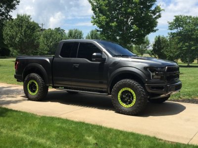

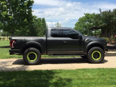

Howdy, I finally posted as I have started hunting some answers as I mod my truck. Been on powerstrokearmy getting my f250 built and ended up with a new raptor this year. It's a dark grey supercab with every option. Mods so far are full ceramic pro inside and out,JMS boostmax and pedalmax, spd turbo adapters, rpg 1.5" collars(need more height), 18x9 0mm SOTA Novakanes with shocker yellow sim u locs by OMF Performance, and 37x12.50 nitto trail grapplers with a little rub even after trimming the firewall. Still working on that part!
Welcome. Great color. Yours is the only other scab I've seen besides mine in magnetic. I've got the RPG 1.5 collars in front also. You have any tire rub with the 18" wheels and the 37's?
Thanks. Ya I do. I have had to grind the pinch weld back 1/2-5/8". The main reason is the wheels being a zero offset. SOTA doesn't make anything different at this size and I was stuck on this wheel

That looks awesome. Gotta make some tweaks for that look you're looking for, and you nailed it. Well done!
Thanks y'all. I love this truck. Almost went with black but I hate keeping them clean. I am going to get a taller spring perch collar for the front, possibly from icon, and hope that clears the tires better. If it sits low in the back after that, I figure it might be worth looking into the +1" deavers. Or +3", depending on how you read the description I guess.
Nice SCAB. Little concerned you are dissin the black SCABs. (I love mine) but yes pain in the arse to keep up with it. I did a Cquartz ceramic coating to keep it fresh.
