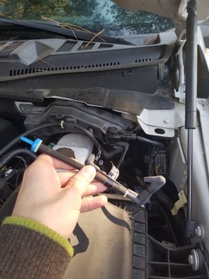

Probably an IWE that went bad. These things are failing pretty fast. Cheap check valves. Confirm by switching to 4x4 to see if it goes away.
I just had the exact same thing happen on my 17....It is indeed the IWE check valve...simple $20 piece you can order or take to Ford...search IWE Ford valve on YouTube and there are a few videos.....I ordered an extra valve and threw it under the seat when the other side does it....Good news its an easy fix...do it yourself or i had an appointment already in the books so Ford did it...
I own a '17 Raptor with 21k miles. This is definitely an IWE check-valve problem. I bought 2 new ones (one as backup) from dealership. $20/piece. This cleared the problem immediately. I noticed funny noise originally when I was pulling my 7k lb travel trailer. The noise sounded like ball bearings in a blender and only happens during deceleration without foot on pedal or break. Noise went away after I engaged 2 wheel drive into 4 wheel drive. The 4x4 transfer is regulated by a vacuum system to which this IWE check valve is most likely the weakest link. I brought my truck into dealership for piece-of-mind after I replaced part myself. Dealership couldn't find anything else wrong. Love my truck but still concerned about towing heavier things (7k-8k lbs) over longer distances with back-end sag. Any people have any advice on air bags, timbren SES, etc? Thanks!
