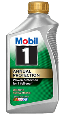

    Oil is the life blood of the Raptor and the key to avoiding failures.
    The engine oil lubricates the turbos. The engine oil (pressure) adjusts the Cam Phaser. Ford is a for profit company and to save costs and increase profit, they don't use the best oil filter or the best oil in the Raptor straight from the factory.
    I've had ZERO issues with my 2019 built in April, but as a pilot, I understand the importance of oil, specifically Synthetic oil in keeping a high performance engine alive.
    At 500 miles I changed the factory oil and oil filter. I use Mobil 1 Annual Protection Ultimate Full Synthetic, designed for vehicles with turbo chargers. I also change my oil at least every 5000 miles and no more. I use Mobil 1 Extended Performance Oil filters.
    I've seen several YouTube videos of oil filters cut open and the Motorcraft filters have very poor quality control especially in the even spacing of the filter media which affects filtering efficiency and effectiveness.
    Mobil 1 Annual Protection oils are recommended for all types of modern vehicles, including high-performance, turbocharged, supercharged, multi-valve and fuel-injected engines that are found in passenger cars, SUVs, light vans and trucks.
    Mobil 1 Annual Protection 5W-30 meets or exceeds the requirements of:
    · ILSAC GF-5
    · API SN Plus Resource Conserving, SN Plus, SN-RC, SN, SM, SL, SJ
    · ACEA A5/B5
    · Ford WSS-M2C946-A, WSS-M2C946-B1 (2019 Raptor Spec)
    What makes Synthetic oil so special? Why does it even exist?
    Synthetic oil was developed before the Second World War and saw widespread use with the invention of the jet engine. The jet engines high engine temperatures and RPM's opened the way for the first wide scale use of synthetic oils. Meanwhile, development of automotive oils continued, and in 1975, the first commercially available synthetic motor oil was launched.
    Since then, and in response to the need for better performing oils, the use of synthetic oils has increased and many auto manufacturers now require the use of synthetic oil in engines.
    The benefits of synthetic oil arise, in part, because it has uniformly consistent properties, unlike crude oil, which is a mixture of hydrocarbons of varying molecular structure and size. Additionally, synthetic oil contains fewer impurities that affect the durability of conventional motor oil. Consequently, synthetic oil lasts longer and provides a significantly greater level of engine protection.
    What is Synthetic Oil?
    As the name implies, synthetic oil is made with products that are chemically manufactured. These products, primarily polyalphaolefins (PAO) and esters, possess many of the same qualities as crude oil but without its disadvantages. The chemical processes permit tight control of the molecular structure of PAOs and esters, ensuring the final oils have uniform and stable properties.
    However, some synthetic oils are made from highly refined crude oil. A process known as severe hydrocracking breaks the long chain hydrocarbons into shorter, more uniform molecules and at the same time reduces the level of impurities in the oil. The oil produced, known as API Group III oil, has almost identical properties to synthetic PAO oil and in the U.S. is regarded as synthetic.
    Why You Should Use Synthetic Oil
    Modern synthetic oils are compatible with all engines, provide better engine protection, and improve performance due to their lower friction characteristics. Selection of the right synthetic oil is easy if simple guidelines are followed:
    • Choose a viscosity rating as specified in the vehicle handbook.
    • Verify the API or ACEA oil specification.
    • Choose an oil with the same or higher API classification.
    • Check oil complies with any mandatory auto manufacturer oil specification requirements (these are usually shown on the oil container).
    Provided the oil complies with the above requirements, it will be compatible. Bear in mind the use of synthetic oil is mandatory in many modern vehicles, especially turbo-charged models, and the use of non-synthetic oil could cause engine damage.
    Synthetic motor oil provides the following benefits:
    • Longer engine life
    • Lower emissions
    • Excellent winter performance
    • Enhanced engine wear protection
    • Minimal deterioration between oil changes
    • Cleaner engines
    I have had ZERO issues with my 2019 Raptor and I haven't had to add a quart of oil because I'm not loosing it being burned up in the turbos. And believe me, I DRIVE my raptor.
