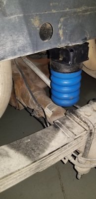

    These and Icon +3 in the back, Geiser springs in the front. Gotta space the bump stops better than shown in the picture but you can see the concept.
