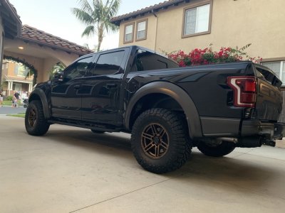

    I purchased a set of eibach to level my 2019 raptor. I’m getting them installed this week along with a set of 17” venomrex 602s. I’m debating between 35x12.5 or 37x12.5 ridge grapplers. I love the way the 37s look, and wanted to know if anyone is running a similar set up with good results. I don’t mind trimming the liners, but that’s the extent of the work I want to do to fit them. For not I’ll be on the stock rear suspension, but will likely upgrade to deavers in the spring.
    I will be doing mild off roading (no jumping)

    I'm running the 602s with a 35x12.5. 1.75 leveled front with the icon attitude collars and I've been pretty happy. Anything taller and my truck might not for in the garage lol. The taller you make your truck the more likely it is to roll depending on how you "off-road"

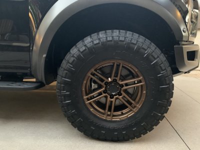

    So I had the tire shop test for a 37 on the front and it was only going to rub on the inner fender liner. A little trimming would have been all that was needed. With that, I still ended up going with 35s. The only reason is because I wanted to be able to use my factory spare tire location and the 37 would not fit. The 37s looked really good, but I chose practicality over looks this time around.

    Stock set up is right at 100# per corner. My set up above is 99.8# (24.4 for the wheel, and 75.4 for the tire)
    That was one of the reasons I went with the venomrex wheels. I was able to keep the same weight per corner and get a beefier tire without a weight penalty.
