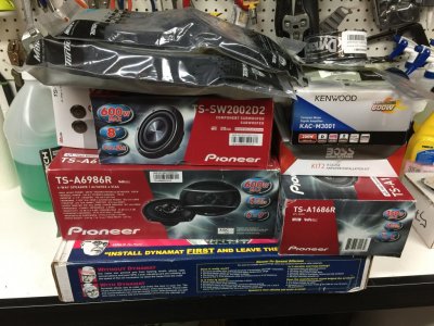

    already purchased :)

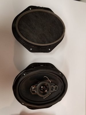

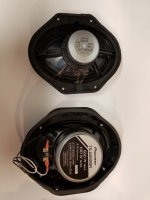

    SO yesterday finished my door / dash speaker upgrade. I used all the Pioneer speakers already listed in this thread (or very similar - there are lots of little options 3-way, 4-way, 5-way) - I spent maybe $220 for speakers ( fronts 6x9, dash 3.5 inch, rear doors 6.5 inch) ford connectors and mounting plates and some foam weather stripping. I did buy some Dynomat but I didnt use it (yet). As i mentioned earlier I want to go step and by step so i could report back to the group what I think made the biggest difference. Now obviously my little experiment is far from perfect because its cumulative and it depends on what order I did things.
    All that said. for $100 replacing the front door speakers made the single biggest difference to sound, both loudness and quality. As you can see from pics above there is a pretty big difference in the sony stock door speaker and the Pioneers. Also I choose the Pioneer not just because of the attractive price but more importantly because of the frequency response AND the sensitivity. Clearly these Pioneers dig a lot deeper than the stockers and the added sensitivity makes up for not replacing the amp which is probably not very powerful.
    So after replacing doors and dash - I did NOT replace sub or A-pillar tweeters - the sound is very good. Much louder, MUCH tighter bass - those 6x9's kick! and a lot more clarity. Sounds pretty damn good now.
