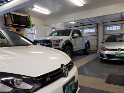

and you are correct . . . i drove it from the dealership right to Belknap Tire in Laconia NH . I had ordered the wheels back in February and they were all mounted ready to go !!!! She had 47 miles on the odometer !!!!! It's an addiction I know !!!!! haha
