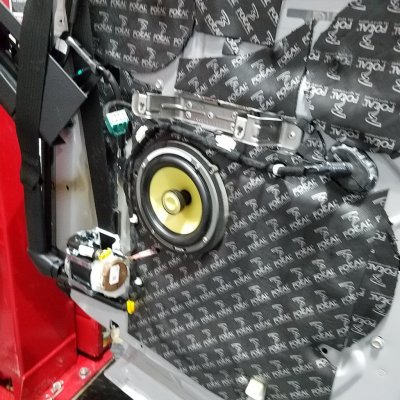

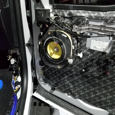

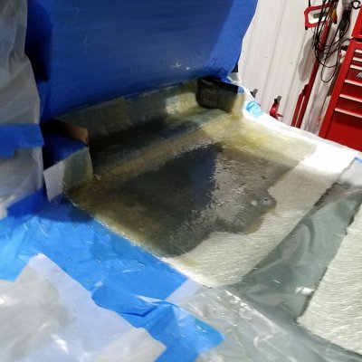

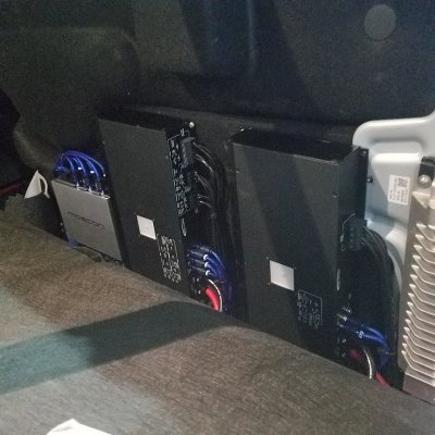

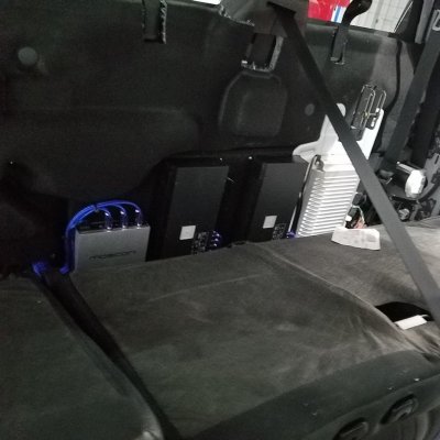

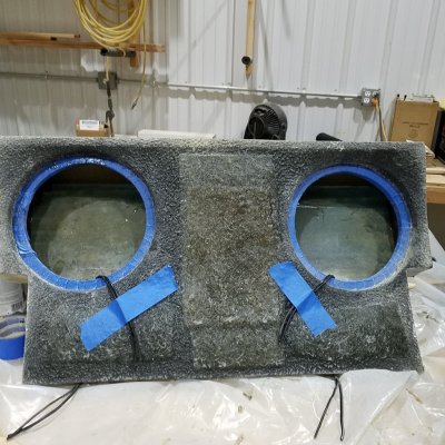

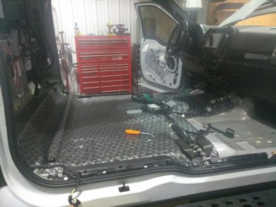

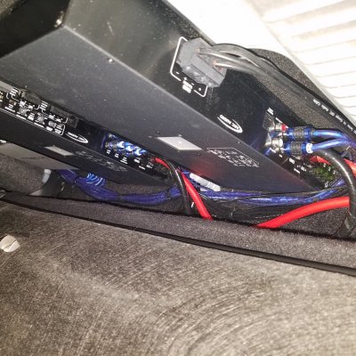

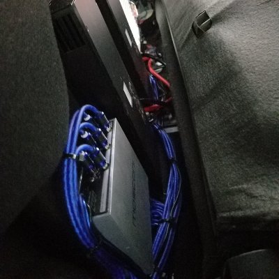

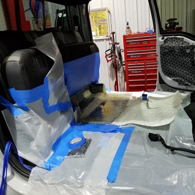

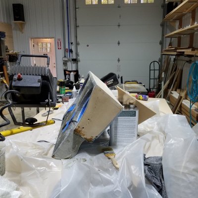

    For lack of better place to put it, I figured I would do a new thread. So here are a couple pictures of the almost final install. The installation was done at my shop and fabrication was done in my wood shop next door. Most all work was done by Noah Stebbins from the Car Stereo Company. He will travel and do installations just about anywhere if you give him air fare, Dr. Pepper, food, and a place to sleep. The work took about 4 1/2 days, and the tuning took about a full day.
    There could be a roundy round about the choice of equipment, the value of doing so much insulation, blah blah. I let Noah pick most of the parts, and it boils down to budget and your listening style. The sky is the limit when it comes to components and the trick is to get a good balance so everything works well together. I like good ol rock n roll, so I'm running a pair of 10" subs and they are incredibly clean and tight. That is also as big as you can get without major surgery to the interior or having them stick out into the footwell bigtime. The rest of the equipment speaks for itself except the sound deadener. This shit is expensive and arguably marginal returns. I feel it is doing an awesome job, but we did EVERYTHING. Inside doors, door faces, roof, floor, firewall, back wall, and IMO the truck is way quieter. It changes and improves the listening environment a pretty large measurable amount. I guess I coulda gotten a bit scientific and done before and after decibel readings, but ummmm nope.
    Overall, the system lives up to what I was hoping for and then some. It actually gets me to listen to music I normally wouldn't because I find myself looking for anything that is well engineered and recorded. Noah did an incredible job of tuning and creating the stage considering the speaker locations are essentially in the stock locations. This obviously isn't for everyone as the price tag is 10K, but keep in mind this is very much a simple mid level stereo by high end standards. If you enjoy your music as much as I do and you feel like getting yourself a cool birthday present, this is the shit. Noah is over on the other site a fair amount, but you can pm me if you want his contact info. Here is a basic rundown of the job. 20171110_072144.jpg

    mosconi 6to8 (sound processor)
    arc audio xdiv2 1200.6 ( speaker amp)
    arc audio xdiv2 1100.1 (sub amp)

    fiberglass sub box custom to be made on site

    20171108_073922.jpg 20171110_072147.jpg 20171110_072032.jpg 20171110_072223.jpg 20171110_072139.jpg

    The pictures don't show a finished product- the wiring was all tidied up, the sub box finished to perfection, interior put back together without a hitch. I will post some finished pics in this post later.

    Focal 6.5" speakers are used with custom mounting plates. Not to sound snobby, but these are in a different zip code from 200 dollar 6 x 9's. The smoothness of these speakers is amazing, but like I said above, not for everyone. The sub box was made literally in place and fits perfectly, there is zero bounce in it. I'm going to the shop later and will take some pics of the finished product. I'm not into blingy stuff so there is no cutesy lights or showy display, just a good, solid install.
