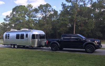

    Thanks Ray, that's really helpful. Once I get a couple thousand miles on my truck, I'll be towing some and will be right at the 800lb tongue weight limit. I've been researching all kinds of ways to support it without any permanent changes to the suspension. My towing will be on flat terrain at sea level and rarely more than 150 miles but I can't live with a non-level setup!
    Planning to use Equalizer hitch. Ed

    DAMN - nice AIRSTREAM !!!! what is the weight ? how was the ride?

    I haven't weighed the whole rig but the trailer is likely about 7,400 lbs. Got the tongue weight down to 800 by removing the propane tanks (we have the convection microwave option instead of gas oven) and creative loading. Tools and Honda generators, as well as clothes etc., in rear of trailer. Sill have more than 10% tongue weight. Using a Equalizer w/d hitch. It towed great. I'm shocked at how effortlessly the Raptor pulls the trailer. Coming out of a F-250 PowerStroke I wasn't expecting it to feel as strong as it does with the trailer attached. Probably right at the max load for the truck but with tires at 45lbs cold it handles and rides really well.

    wow nicely done.. and good to know - appreciate the info. A buddy mine had his work truck in a the shop and asked me if would help get his boat out of the water for the season. he said 7000 lbs with boat and trailer. Problem is I have a Super cab not a crew. Would be a very expensive wreck of a 100k boat and and a 70k truck!! hahaaaa
