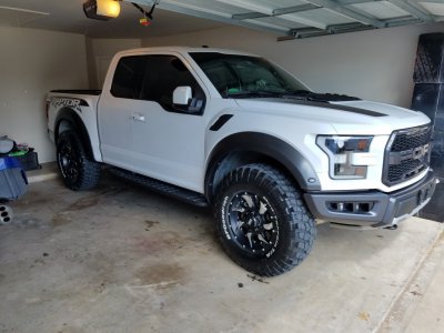

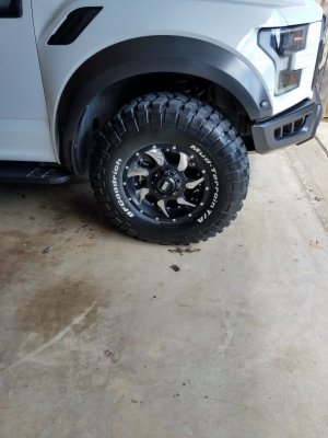

    Upgraded to an 18" wheel and a 37" tire.
    Other then going from a KO to a KM and i expected a bit firmer ride, it pretty much drives about the same and not having any balance issues ever at 100+
