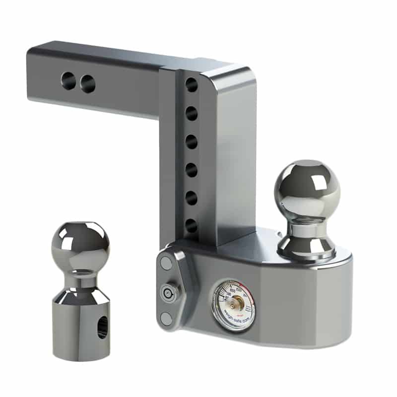

Yup, that is what I am thinking - an adjustable. But with drops from 4-10" I wanted to start eliminating some of them. These are what I am considering: https://www.weigh-safe.com/
pretty cool hitch - and useful. What size you thinking? I am so lost as to how big I should get it. 10" just seems like it belongs on a F-750 and 4" on a Focus.
Was thinking 8"/9" but that seems like it may be too much. But always better to have a few extra inches then not enough. https://www.etrailer.com/mm5/merchant.mvc?Screen=BASK&StoreCode=E&site=5
