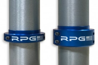

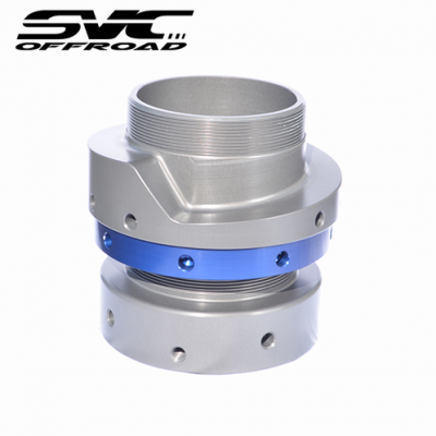

Here are the two options available; http://www.rpgoffroad.com/product/2017-raptor-coil-spring-perch-collar/ https://www.svcoffroad.com/product-page/2017-raptor-c-a-s-coil-adjustment-system

We've been selling quite a few of the RPG perch collars and can confirm that the 1.5" kit will essentially level the truck. If you're looking to add a heavy front bumper, winch, etc, you might want to consider the 3" collars. The SVC C.A.S. setup is nice as it gives you quite a bit of adjustability from ranging from around 1" upwards to 2.5" and anywhere in-between those. More information and pictures here: CROWN OFFROAD RPG Perch Collars: SVC C.A.S.:

Gdog, I would say the RPG collars are the best bang for your buck, the cost was around $500 total out the door with install and new alignment, so I would say reasonable for what your getting. Objectively, I would say my Raptor is not actually "leveled" but it is much better than factory. My truck had a huge rake from the factory when I first measured it was almost a 2.75 inch difference, so the 1.5 inch increase definitely helped out and to the naked eye it passes as leveled, but not if you were to fully measure. Anyways, I've had these collars on almost since my truck was new and see no downside to getting this mod done. The truck looks better and actually the suspension feels better due to being slightly stiffer but you can barely notice that. Again, I think its a good well rounded "meet in the middle" sort of mod being not too much but certainly making a difference. I would worry a little personally about the 3" collar and how that could potentially affect the suspension. Just my opinion, hope that helps.
