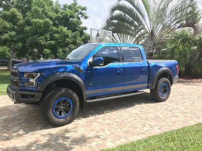

    Rather than add additional parts and have another point of failure, I saw the opportunity to use a longer spring with more weight bearing.
    Eibach came out with the new Pro-Lift Performance Lift Springs. Link is here.
    No difference in ride or handling so far. You can feel the difference in your ass in the seat as well as when you climb up in the truck. Springs cost about $200 and gather install and alignment was $290.
    Looks good, feels good, so far I am happy.
    top of wheel well was 39.5" and now its 41.875

    Looks sweet! I like the idea of going with a new spring over adding preload.
    I like the beadlock rings.

    Nice beadlock Rings. Did you paint those to match?

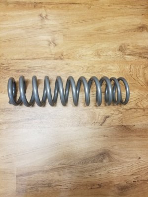

    Geiser is making a spring. I just got a set. They are not for sale yet. Not for several weeks. I got the first set of final springs. I'm putting them on Tuesday.

    Thanks for the information. I have been debating these for a few weeks. I want it leveled, but I think I'll focus on researching other options or give it a little more time and see if another/softer spring comes out. Truck looks great man, I love the Ford Performance panel decal.

    Very interested in the ride characteristics of these Geiser springs. Are they variable rate?

    Progressive rate springs.
