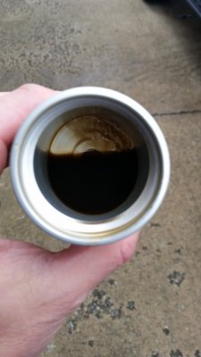

    3000 miles. Highway and hammer down driving. Smelled of fuel, not surprising. Had some white gelatinous gunk on the bottom...Maybe 1/2 cup total.
  13. Gdog
    More proof these cans work. Thanks for sharing
