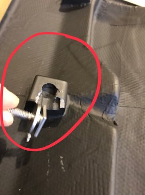

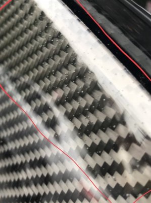

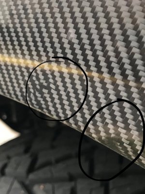

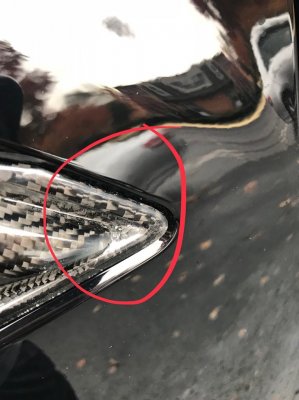

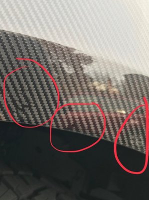

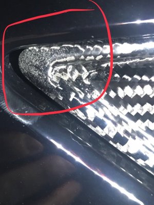

    Stay away from Icon Composites. Not cheap and some of worst carbon weave I've seen. The clear coat has bubbles on all the pieces. They market having some of the finest carbon that's made in the USA, what a joke. I've seen better Carbon that came from China. I'm just here to save the next guy from getting scammed by these guys.

    I’m not a carbon expert but I worked in a carbon shop for a bit. The biggest thing you can do to ensure a solid piece is pull more vacuum when baking it. If you can’t pull enough vacuum, you will get the bubbles and pits that are in these pictures. As far as the weave being messed up, that’s just poor handling when laying the carbon into the molds.

    look here guys I'm not the only one with an issue with these guys. They are a joke save your money. Hey Corey send me a replacement without having to put up the money for the replacement kit like you requested. Or give me a refund like you also had said you would do. This is what any reputable company would do. That's how you stand behind your product 110%. Your product sucks i don't' know how you can even make that calm. You're a conman I really hope no one else gets ripped off by you.
