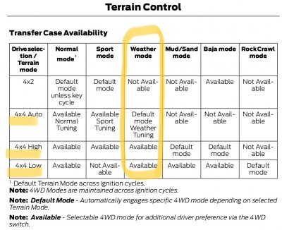

    I used this image to help explain what transfer case modes are available in Weather Mode but could also be used here.
    With roughly 6k on it now with 4k of towing - My transmission seems to be fine, but I didn’t buy the truck to beat it like a red-headed stepchild either.
    If I were having problems like some of you, I think the first thing I would do would be to disconnect the battery overnight and start the relearn process over again by driving the truck “normally” to then assess the transmission’s condition.
