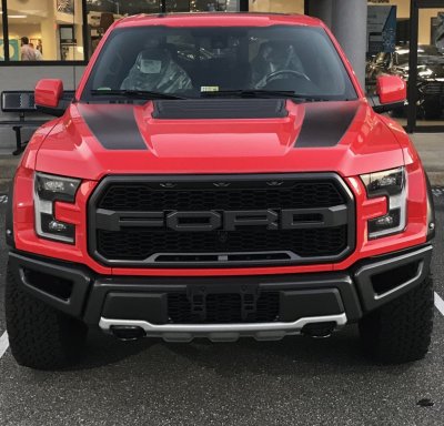

    fullsizeoutput_84e.jpeg sooo I have 645 miles on the Raptor. So far, love it like no other vehicle I've ever owned. Plugged in Pedal Commander yesterday and it's like a new truck all over again! Got the rear wheel wells sprayed by LineX, added a stubby antenna, and wrapped the front hood/mirrors/fender flares with Xpel
    Just wish some of the $70K i spent went toward doors that didn't rattle at even low stereo volume, and the ability to control some features like auto fold mirrors, shutting off fake engine noise, etc. Tried FORSCAN yesterday but I can't get the changes to take so more to follow on that one. fullsizeoutput_84e.jpeg
